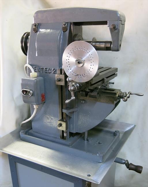

Centec 2 Mill originally fitted with lever operated rack and pinion feeds.
X and Y feeds had optional feed screws and nuts
Z (vertical) axis feed was developed from a bevel gear hand drill mounted in the purpose made machine cabinet with the feed handle roller bearing mount extending through the cabinet.

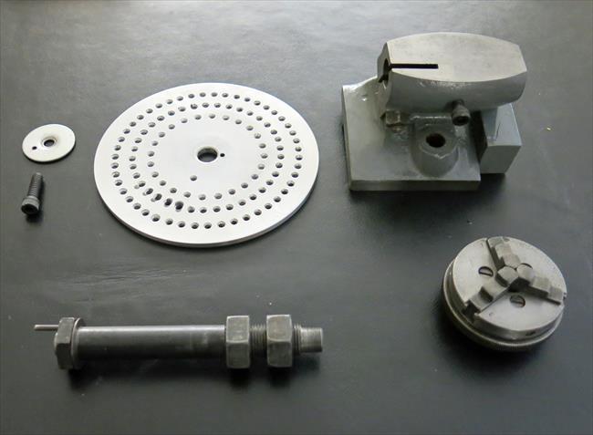

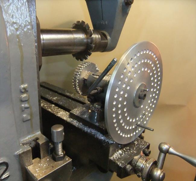

To provide component indexing a `spin indexer' was developed by converting a tailstock casting.

CENTEC 2 set up as Horizontal Mill
Dee Bee

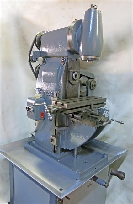

CENTEC 2 Set up as Vertical
Dav Brad photo
Spin-Indexer for Centec 2 Mill
DavBrad Photo
Using Spin-Indexer on Centec 2 to cut gears
DavBrad photo
