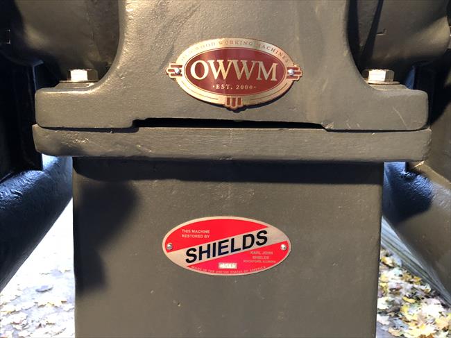

When we were able to take a good look at the sander, several things became apparent:
- "Greenlee"............................nope, it's a Crescent
- "Tilting Work Tables (one missing)"...no, both tables were present
- "Double End Disc Sander"..............not exactly--one of the DISCS was missing.
Even so, the sander was otherwise in good shape overall,and I thought for certain that a new disk was actually easier to find or manufacture than a missing table.
A much, much longer story, cut short: Neal and Panda Dan Warner started working on the a new disk at the 2017 WamFest--it ook a bit longer than anyone anticipated. Turned from steel plate, the replacement disk runs very true. A HUGE debt of gratitiude to Neal and Dan!
Other details:
* I can find no evidence of a serial number, but given some of the degn details, I would assume that this is an early machine, dating most probably from the 1930s.
* The motor is a 3-phase 3-horsepower Master motor, turning at 1200 RPM.
* According to the documentation here, http://www.vintagemachinery.org/pubs/224/52.pdf, the 3-phase, 3-HP machine has a telegraph code/designation of NECEI, and weighs 1100 pounds.
* The paint is Sherwin Williams Industrial Enamel in Graphite.
This sander had been heavily modified before my custodianship began. The original motor spec lists 1750 RPM, but the motor tag indicates that it has been modified to run at 1200 rpm. The original grease-fed bearings have been replaced with sealed. The original table locking mechanisms have been upgraded, as this iteration of the Crescent sander pre-dates the addition of the crank and rack for table angle adjustment. In stead, and under-table screw adjustment had been installed, which can be seen in the "Before" photo below. I have elected, for the time being, to not re-install them.
Thanks to all who had a part in getting this "Greenlee" running!

Badges!
My iPhone 8+
