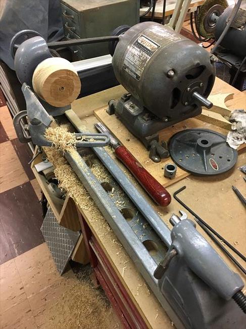

Powered by a Craftsman ½ hp 1750 rpm motor on a pivot mount.
A block of wood under the motor keeps excess load off the lathe bearings.
Test cuts on a slug of white oak attached to a 3" faceplate.
Test run-October 2018

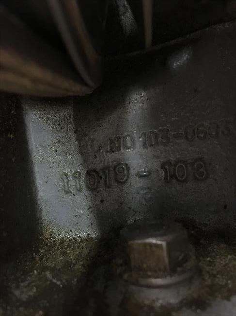

Lathe model and part number inside the head stock

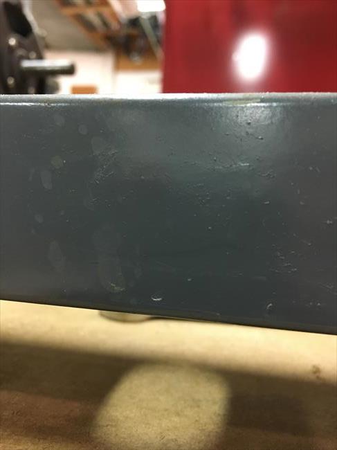

Companion decal outline on bed under gray paint

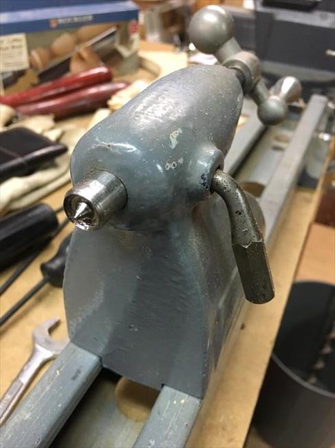

Steel ½" tail stock spindle with integral center
