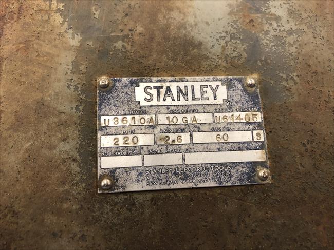

Tim Aitken
Power Shear
1930’s - 1940’s ?
U61405
9/27/2018 11:05:11 AM

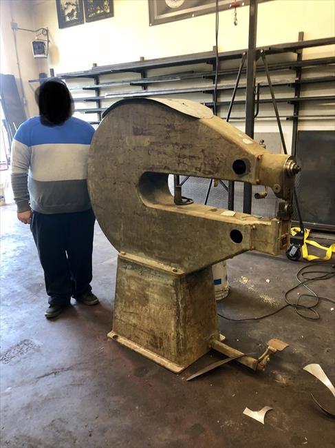

Looking for info on this machine, I recently bought it and can’t find anything about it, it works great, foot pedal raises and lowers the bottom die, it weighs around 1800lbs
[ADMIN NOTE: Who knew that Stanley Electric Tools made a big machine like this? It was hard to find because they also made handheld power shears, but I found it in a 1954 catalog; see Photo 3. Link to catalog is below.]
