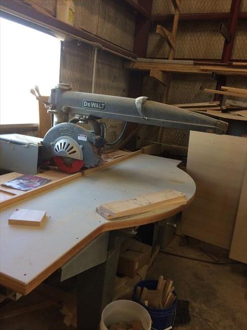

Craigslist purchase from original owner. A sign maker in Colorado Springs. I built a new table, changed motor and yoke bearings, squared it up and put it to work. Purchased bearings and new old blade guard from Wolfe Machinery. Also added a mobile base under the factory legs. The saw came with a huge dado head blade guard. This setup will cross cut 30 inches dead on square. All my cabinet parts get cut to length and squared up on this saw after ripping to width on the table saw. My favorite machine in the shop!

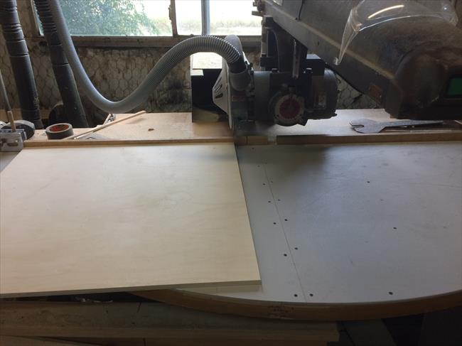

cutting cabinet parts to length

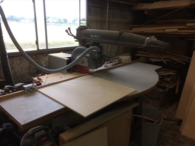

dowel jig for repeatable lengths
