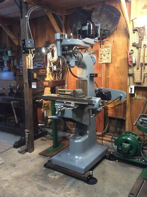

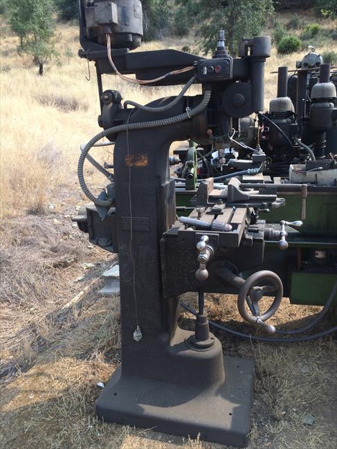

I bought this machine from a company in Jamestown , California. The company manufactures micro drills , and upgraded their machines to CNC . It’s a Index 40 I think. It uses a B&S #9 taper. It has a 3/4 Hp 3 phase motor, and I installed a VFD. The cross feed has a 1/4 Hp DC motor with controller.
Saved it from the scrap yard
My friend helping me unload this 1250 lbs beast

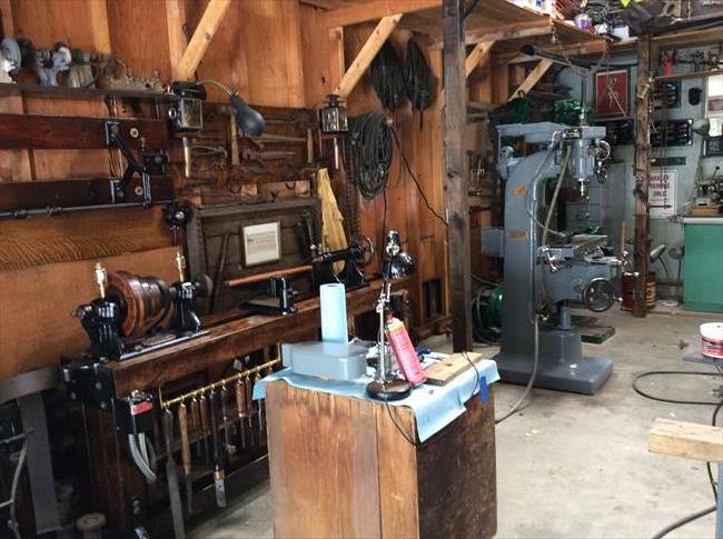

My shop

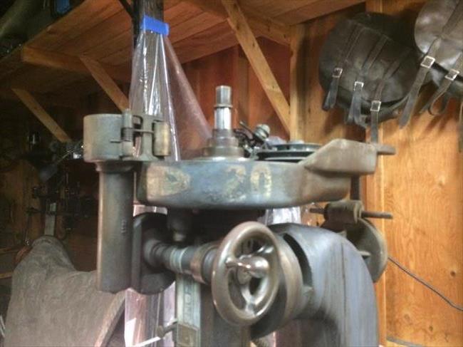

Replaced bearings in power feed unit

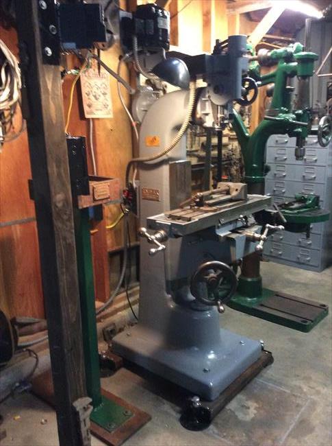

Made levelers and leveled machine. Wired up machine with fused breaker and VFD
