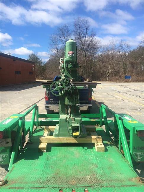

I bought this machine from an auction at the Nashoba Valley Technical High School in Westford, Mass. I had a beautiful 284 mortiser that was rebuilt by Central Machinery in 1997. I bought that one from the Quantico Marine Corps Base a few years ago, but I sold it. I never thought I'd get a chance to buy another 284 that was rebuilt by Central Machinery again, until I came across this one. There were not any details besides the nameplate that suggested to me the machine was rebuilt like my previous mortiser on the auction site, but I was thinking if it was anything like my previous mortiser, the entire mechanical system of the mortiser would have been rebuilt in 2004, based on the serial number. I won the auction and headed up a few days later to get it. They had no forklift on site, so I rented a drop deck trailer from Sunbelt Rentals and used a pallet jack to move it. Notice the large 4' square cribbing I made before moving it with the pallet jack. I used pry bars and a duck bill porta-power to lift the machine up about 1" on each side, blocking up a little at a time until the 4x6's fit under the machine. Used 1/2" lag bolts to secure the machine to the 4x6's and then tie the 4x6's together. You're making a big mistake in my opinion trying to move these mortisers without a similar large base to keep the machine from tipping over. I've moved 3 of them this way now and no issues. I know 2 other machines that were tipped over during transit, completely ruining them.

Loaded on Trailer, Note Wooden Base. Tie Downs Next!!
Me
