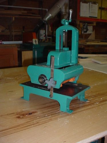

Thom Houser
6" M&M Molder Planer
Early
12/14/2005 2:05:35 PM
Purchased on ebay 11/05 for far to much money but we needed the non power feed for some of our curved moldings.
Tag reads
M&M Molder Planer
Eagle Sales Company
Keene, N.H.

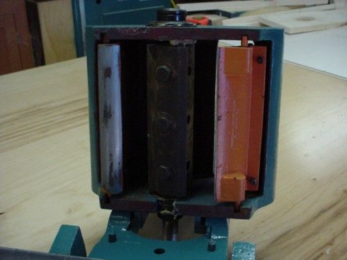

A few notes on the difference between the M&M and Williams & Hussey
1. M&M has a 6" square head but with 4 knives mounted with bolts on 2" centers
W&H has a 7" square head with 2 knives mounted with bolts on 1" centers
2. M&M uses spring loaded presure bars front and rear
W&H uses presure rollers either power fed or not
3. M&M the whole head assembly tips to the right to change knives
W&H the head assembly has a top cover that is removable to change knives
4. M&M the head travels up and down in adjustable ways
W&H the head travels up and down on round bar stock
Running curved molding with 3 point jig
Pressure bars and cutterhead
