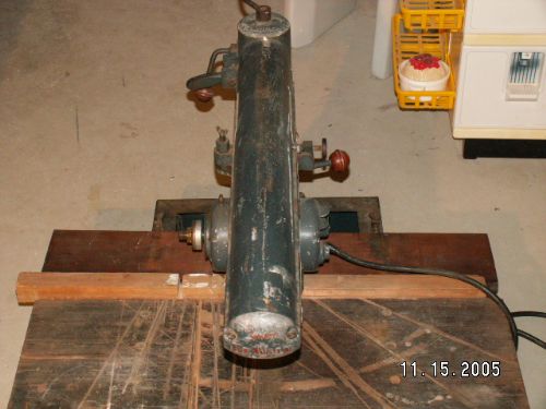

Front overhead view, better pictures to come
my camera

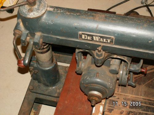

overhead left side view with the missing blade guard obvious
my camera

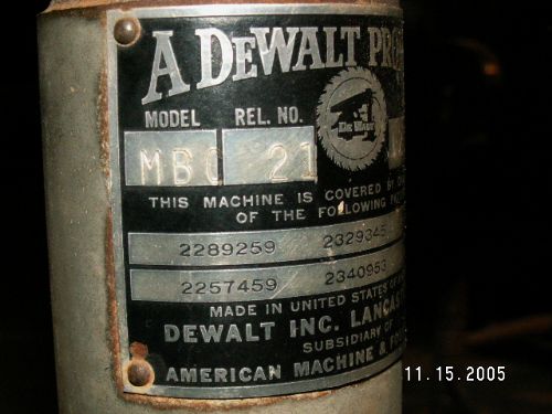

DeWalt badge with model and serial number
my camera
