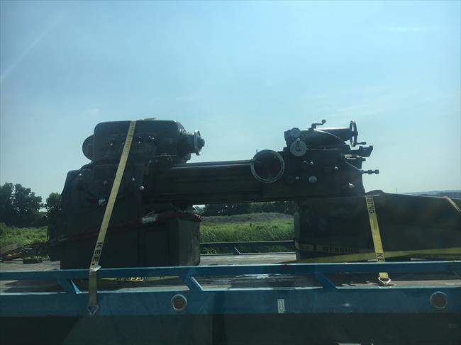

Transporting on roll back
me

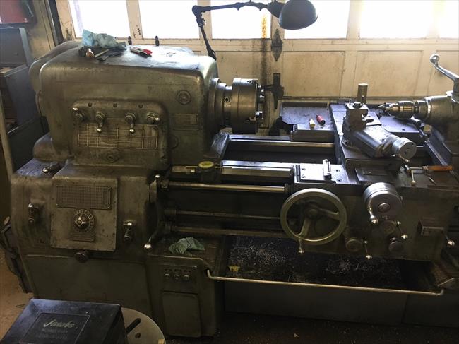

Left half of machine cleaned up a bit
me

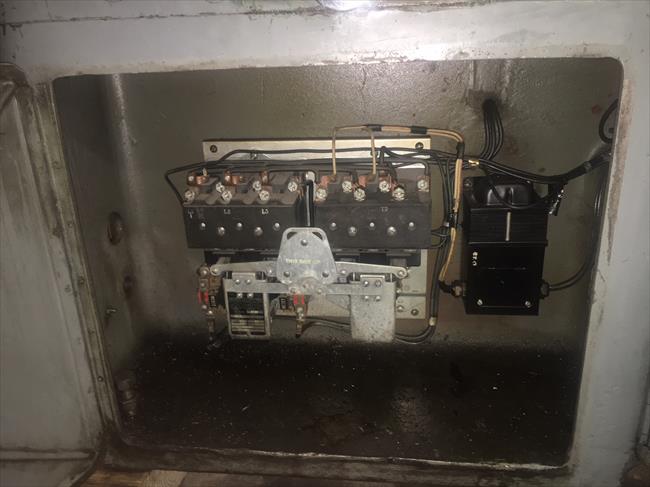

Original size 2 reversing starter with mechanical interlock
me
