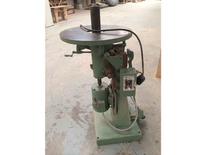

I purchased this Wysong & Miles oscillating spindle sander (OSS) via an IRS Auctions sale for Barbary Industries on June 25, 2014. The OSS was grossly mis-characterized as a complete working machine. It was anything but ~ the spindle shaft was raw 'shaft' material with minimal machining, the lower oscillation housing cover was hacked to accommodate the incorrect shaft, the worm was missing, the motor was 3600 RPM's instead of the correct 1750 RPM's. The 'shaft' was hollowed out and was just slipped over the motor shaft ~ no Love-Joy connection. The one supplied sanding drum was actually a boat trailer roller.

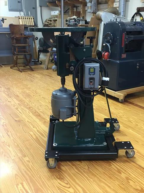

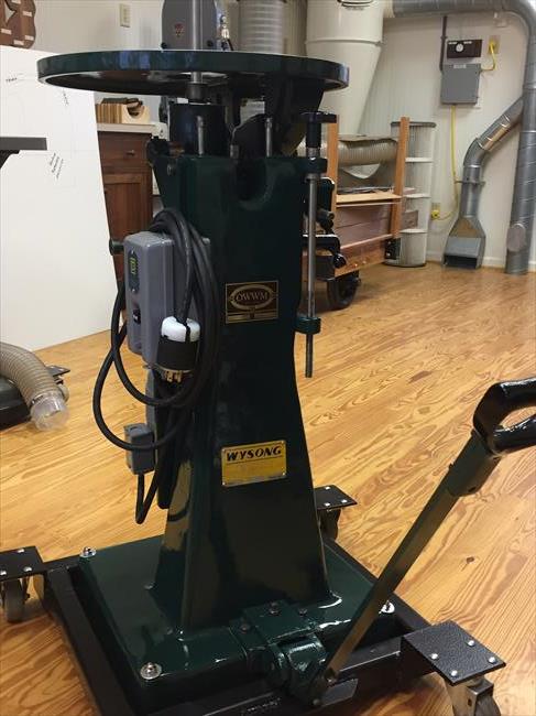

Comments: Custom base using original mobile base handle. Wysong & Miles badging and OWWM badge
Source: Tom Wassack

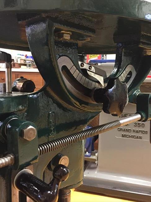

Comments: Oscillation mechanism.
Source: Tom Wassack

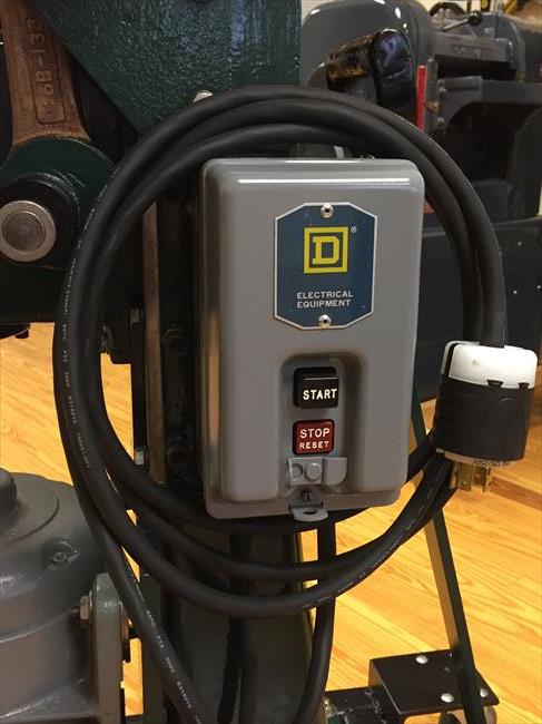

Comments: Restored vintage Squared D starter.
Source: Tom Wassack

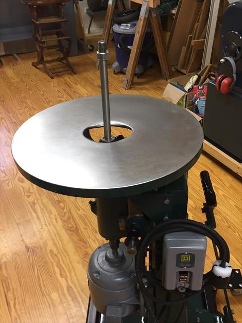

Comments: Table top.
Source: Tom Wassack
Comments: Tilt and table raising mechanism. Gits oilers.
Source: Tom Wassack
Comments: IRS Auction pic.
Source: IRS Auctions
