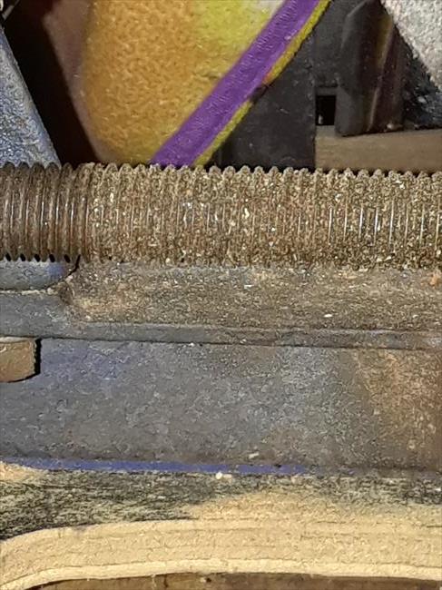

This is the blade height adjustment screw. As you can tell, it took some wrangling to break it all loose and take apart. But it was so worth it. I have a new 1934 Craftsman 8" table saw, saved from the scrappers.
Todd Woodruff, Owner
