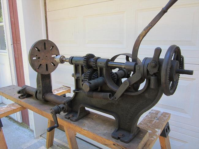

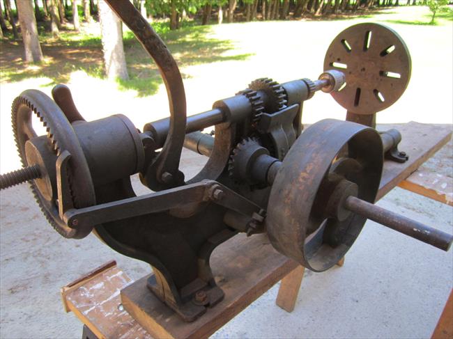

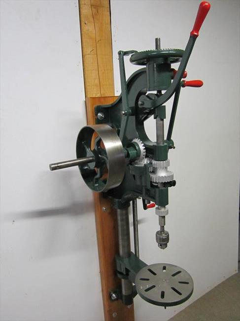

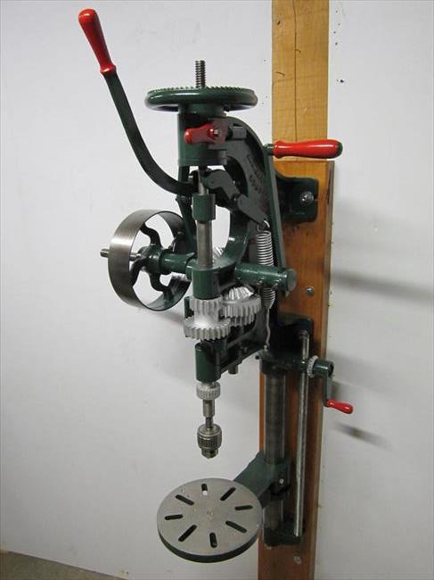

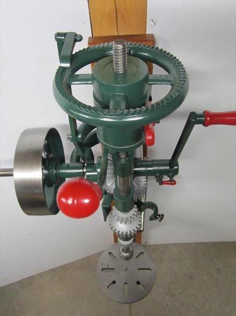

Was in very good shape. No. 80 is same as no. 8 but with tight and loose pulleys for power and without the flywheel.
Missing are: The loose pulley,the handle, the elevating screw, the elevating nut and the top miter gear for elevatig screw.
Broken parts: The hand feed lever (welded), the feed lever (welded) and the connecting nut.
Height: 49¼" without the wooden stud.
Weight: 205 pounds as is, without the missing parts.
