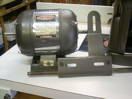

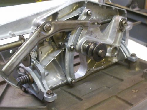

The tilt gear on this saw was damaged so the previous owner sold it to me for $10. Replaced the gear and cleaned it up. New bearings in the motor..... good to go. The motor on this model rides on a bar mounted to a table or stand. The motor doesn't tilt with the blade.
Since there are other pics of this model, I thought a pic of the die cast aluminum trunion would be of value. I have pics of other angles of the trunion if anyone needs.

my cheap digital
die cast aluminum trunion, side front
my cheap digital
motor & motor mount
