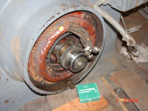

Depicting the stator and rotor with new bearings installed.
I shot the pictures.
