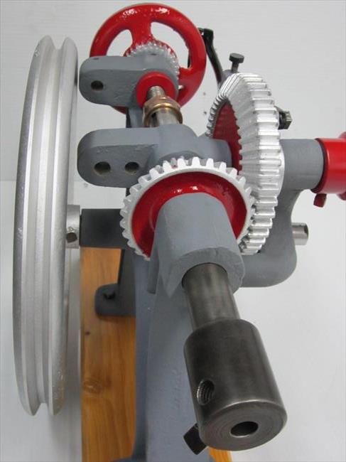

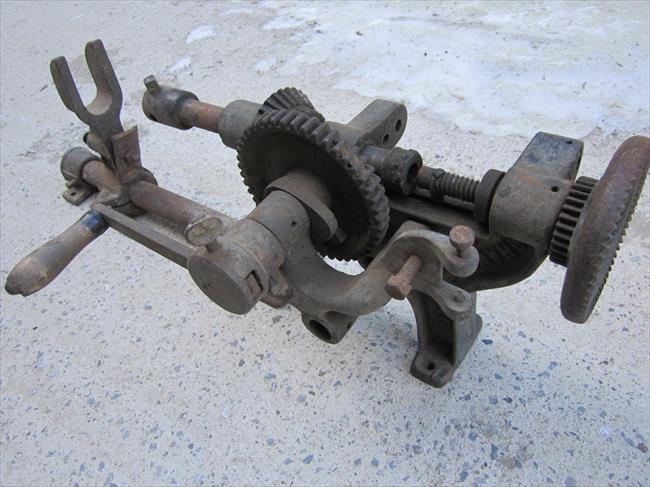

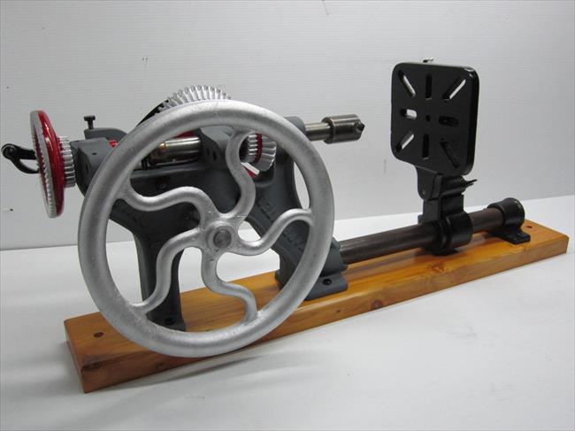

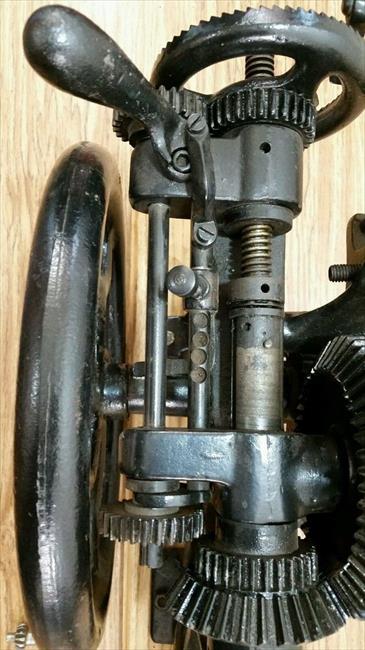

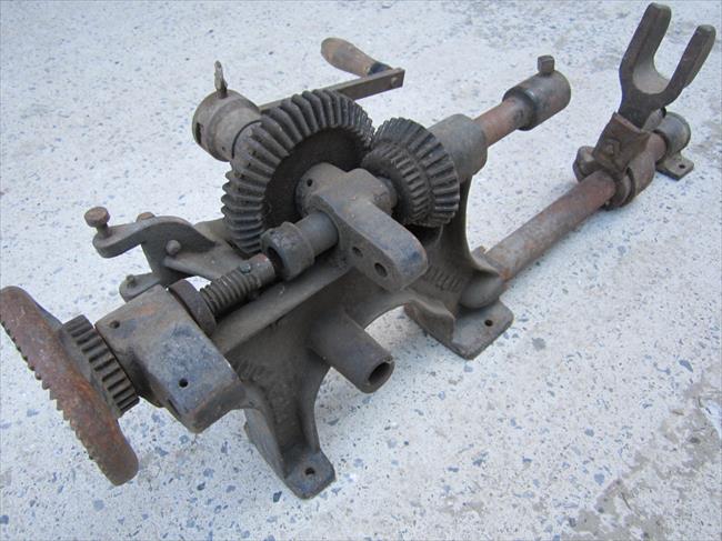

Thi is a quick return self feed post drill. It has two speeds. The feed screw does'nt work, i will make a little groove at the end of it with two half washer to retain it to the spindle. The main frame is broken where the column is attached, will try to fix it later. The table support is also broken. Missing: the flywheel and cross shaft, the back gear, the feed arm ass'y, the table and the quick return lever systems.
I borrowed some parts from my Champion BB in order to take those photos.
Comments: This picture shows up how the quick return lever system's should be
