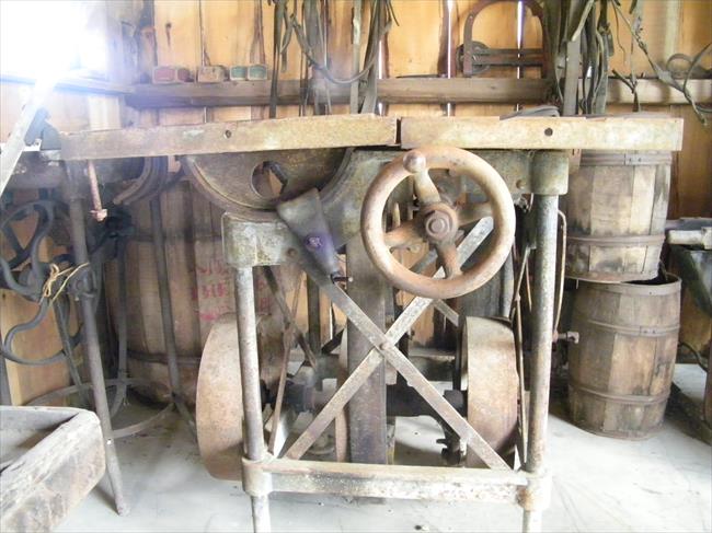

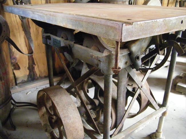

I am told the machine was retrieved from a Panton, Vermont barn this year and given to the local county fair association, where I viewed it this past week. It appears to be an early 20th century small table saw,designed with double arbors, a half tilting top and a 4 inch jointer attachment. The top is of cast iron, as are some of the fittings, and the frame appears to be of iron pipe. The jointer is a round head type. No fences are with the machine at present.
The displayed placement of this saw has made it difficult to examine and to photograph.
This the first notice of a woodworking machine built by this firm.
Comments: front view
Source: R. Bernstein
Comments: three quarter view from the left

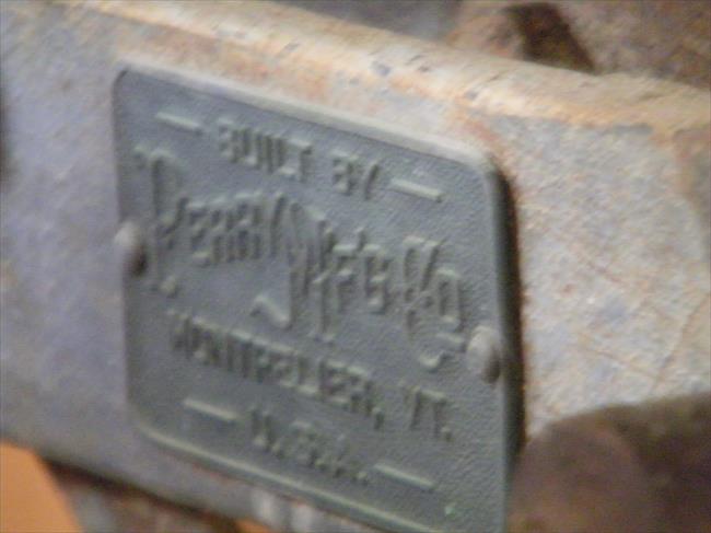

Comments: manufacturer's plate
