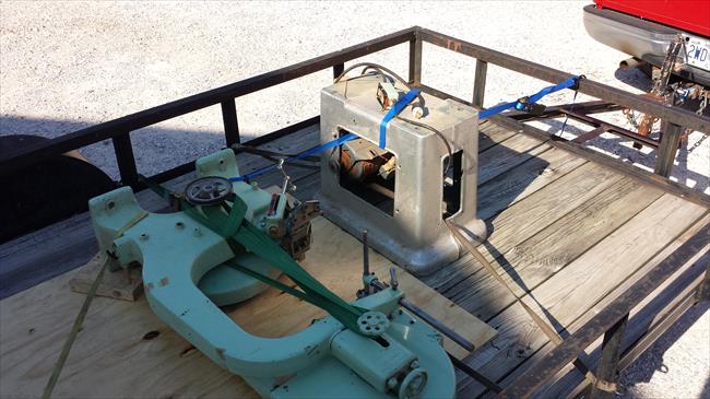

Comments: Bringing home the 1938 Walker-Turner BN1125 16" band saw
Source: S. Vick
