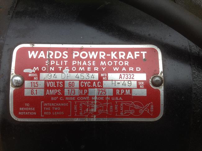

Montgomery Ward | Powr-Kraft
Motor
1/3 HP
Bill Wilson
94DP4534
1949
H-49
6/6/2017 6:28:22 AM
This was powering a Craftsman 4 3/8" jointer ( 103.23340) when I got a package deal off of CL. Today I blew out what looked like a trees worth of chips and dust. I cracked the case open, blew it clean and put a fresh 3 wire cord on it. It runs smoothly, no play in the shaft. I took my time and labeled all the wiring with painters tape so it all went back the way I got it. The shaft appears to have some threads on it (?) but they are not in good shape. I have not been able to gather any info on this motor, so I wanted to post this in case someone else has this motor or info on it's history.
Tag

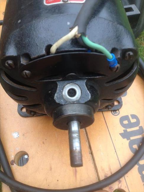

Shaft side

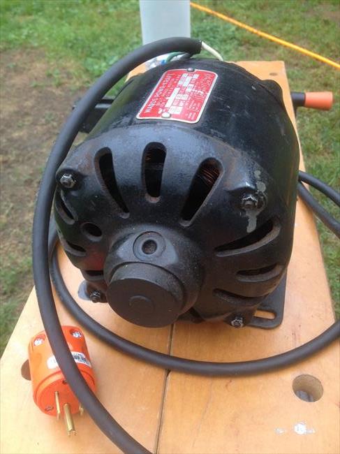

caboose side

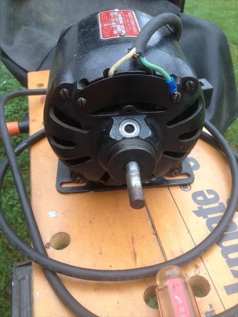

shaft side

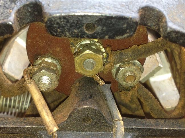

connections with really old wires
