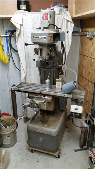

One thing that was very obvious on every machine that I took out of there was, darn near every loose knob was MIA. I have since source all the knobs for this mill. I hooked up the motors and they all ran fine. After oiling the machine, I ran it thru its paces and every thing worked as it should. Even the power table feed. Everything will get new bearings and a really good cleaning before I put it to work.
One major item missing is the over arm and support for horizontal use. I have source an over arm, and will fab up the support.

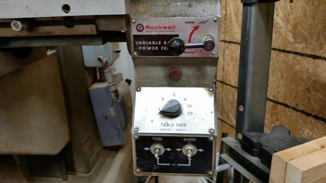

The table power feed is a 1/3 hp / 120 volt.

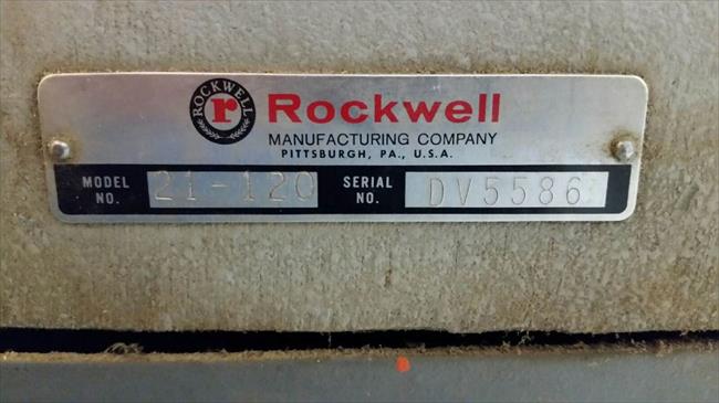

****Special note - The machine tag indicates it as a vertical head only. The Rockwell # for the combo machine is actually 21-122.*****

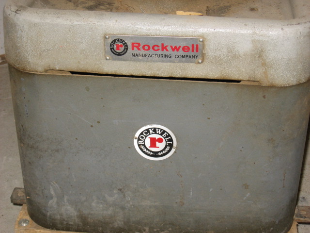

Front shot

Tag - 1968

Power table feed - still works!

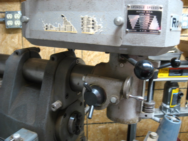

The often missing slow quill feed

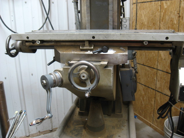

Table and knee
