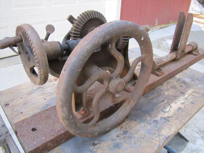

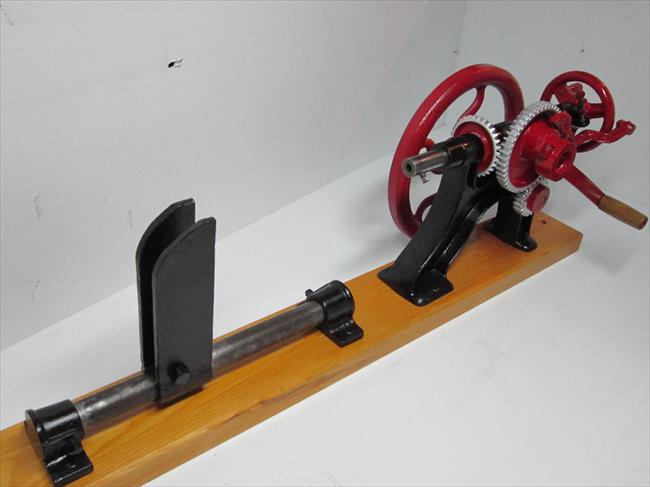

The flywheel is 14" dia. The spindle is 1.135 x 13 1/2" long with left hand threads. The crank gear is 6" dia. with 46 teeth, the spindle gear is 4" dia. with 30 teeth, the flywheel shaft gear is 3" dia. with 22 teeth and the feed wheel is 6" dia. with 55 notches. The feed arm can be ajusted for one two or three notches. Run of feed is 3 1\8". Dia. of the pillar 1 1/2" x 17 1/2" long. Drill to center of 18 1/4" to the board and 14" to the pillar.
The spindle coupler is special, i have'nt seen one like that (photo #4) no leather washer nor bearings.
The two frame spindle holders have been re-drill, that's why we can see longer bushings. The spindle looks quite new, could explain why the diameter is over size when most of spindle are 1 1\8" for post drill that big and maybe why the coupler is so special and the drill chuck so small.
The table is missing and the table support (fork) is not original.
