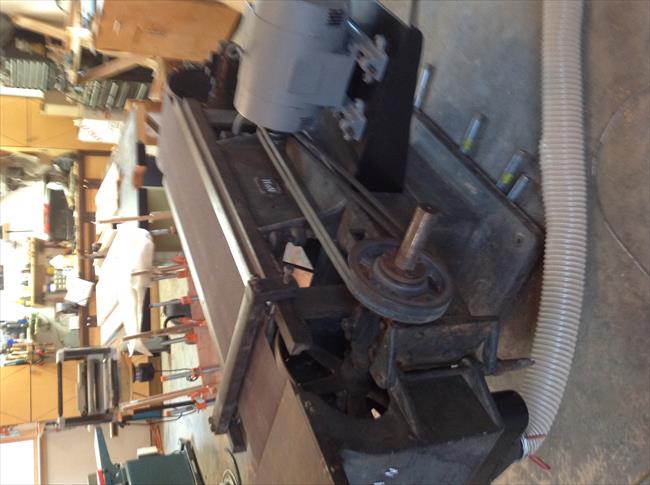

Got it on Craig's from an owner who didn't want to move it. Added a shelf for the 5 HP motor, was previously floor mounted. Drilled and tapped mounting bolts into the iron beam of the sander, iron is fairly to tap. Shelf was made from 5/16" plate steel. Rewired it and added a magnetic switch for safety. Also made an adapter for hooking up the dust collection. This is a working machine, I'm not a collector.
Front view of no 11 sander
