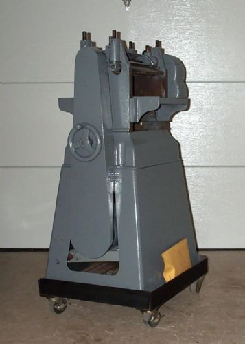

8/30/2006 11:41:03 AM
Purchased for $250 in running condition (2hp Peerless motor seems to have been original). Cleaned and removed light rust, reworked table roller bearings and roller ends, re-set cutter head bearings, replaced knives (old set marked "Parks"), added magnetic starter and new power cords, painted. Shop-made belt guard based on photos from vintage Parks sales brochures found at this site.
Post paint job.
