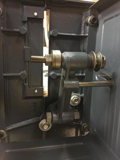

Sears Dunlap "Economy" 8" bench saw, built by Double A Products.
Non-tilting ½"-20 x 1-9/16” long arbor supported by two Oilite bearings in a cast iron housing.
Machined cast iron top attached to a stamped steel base.
Machined steel 1½" diameter pulley.

Arbor
