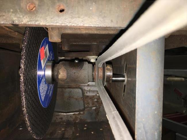

Reassembled and attached to my test stand with a 1/2 hp 1750 rpm Craftsman motor, floating rail, 3/8" belt, and 4" pulley.
An abrasive cutting wheel is installed for slicing metal.

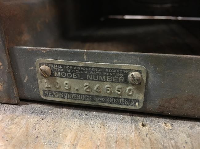

Model tag
iPhone 6S camera - existing light
