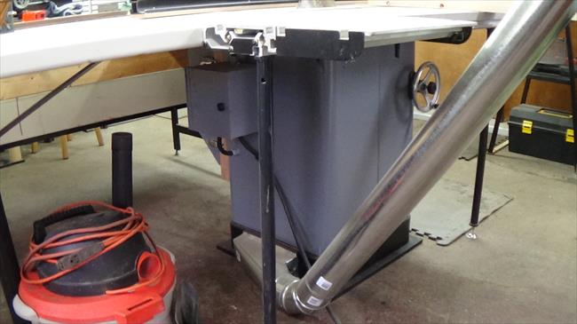

I purchased the saw from a local small cabinet shop.
Restoration was a total strip down.The motor got a badly needed clean up.....new bearings....new cut in switch.The cabinet was stripped to bare metal....etching primer applied with a top coat of dark machinery grey.All other parts were cleaned and lubed....no worn or broken parts.
Made a cover for the side of the cabinet to keep the dust and chips in.
