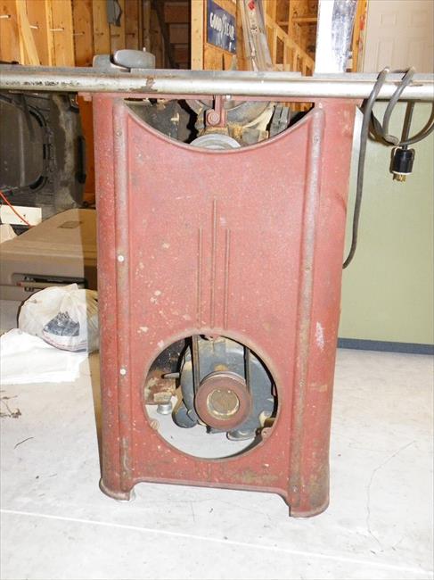

Comments: The hole in the back is missing its louvered cover like on the front. The parts saws will supply a cover. The driven pulley is partly visible here under the table. The arbor tilts on the same center as the pulley so the motor stays stationary while the bl
