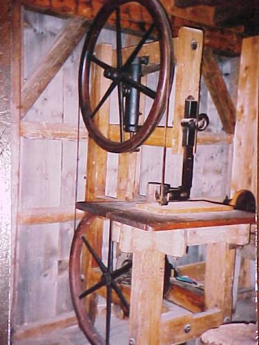

I had already listed this band saw as manufactured by C.D. SMITH of BALDWINVILLE MASS because it is marked as such and patented JAN 6TH 1868. Jeff Joslin ran a patent check and came up empty handed leading him to conclude that it was a fictitious patent intended to scare would be design thieves. The following engraving is clearly of this saw, accurate to the smallest of detail.

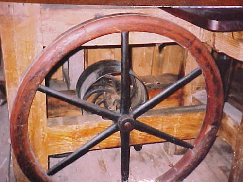

The wheels appeared to be at least 36 inches in diameter but I did not have a tape measure to confirm this. Note their rounded bicycle tire like profile. Also note the rigid "triangular" frame construction which supports the upper wheel and blade guide.
