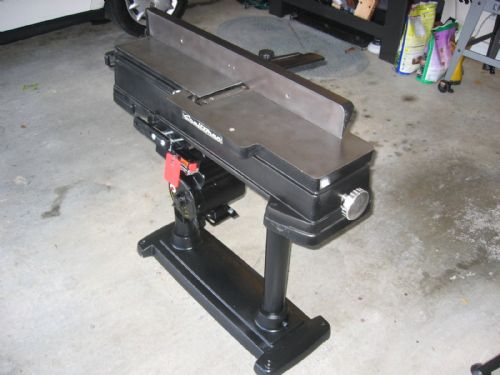

It belonged to my Grandfather who has passed away. Supposedly he used it to build his first house when my father was a boy. My father and I found it in an old shed and it was completely covered in rust and almost every moving part was siezed up. I sand blasted it, put a coat of primer, and then two coats of gloss black paint. I used an orbital sander to finish removing the rust from the top and then polished it with a buffer and compound. I had to replace a few nuts and bolts, knives, and a new motor (2hp).It works great!
Front--not with original switch or motor. It rests on the original stand.
I took the picture in my garage.
