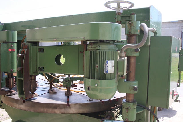

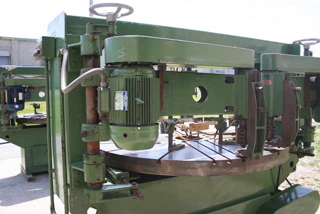

The swing arms held 1 1/4 " spindles for 4" long stagger tooth planer or carbide milled-to-pattern shaping heads. The air holdowns were for multiple jigged part holding templates. The 48" diameter table rotated as parts were loaded.

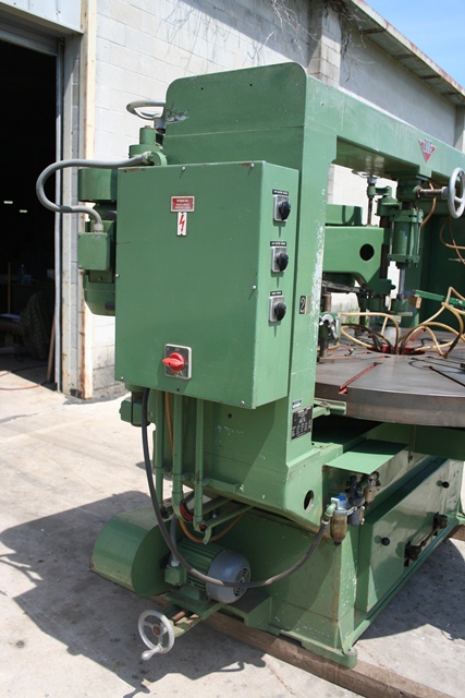

10 HP motors belt driving outboard bearing spindles with template pilot bearings. All spring loaded to shape irregular parts while climb cutting.
cmw

Parts clamps, indispensable extras for these machines.
cmw
Very symmetrical, as well as circular, machines
cmw
