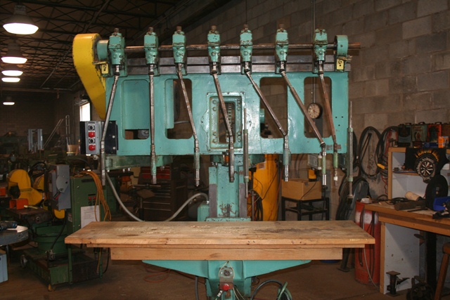

This here borer is a very old specimen, and one that was heavily modified to keep it running over the years by enterprising furniture factory maintenance men on a tight budget, as their corporate bosses ran the plant into the ground while planning to move production to China and close the factory, laying off 100s of workers and helping to give the south that empty, shuttered factory look.
This ancient borer was a mechanical machine, but came with a cobbled together hydraulic pack.
It has the early style chain table raising, to which the maintenance guys affixed a hydraulic cylinder for extra help,
since corporate wasn't sticking a nickel into this company.
It did get a fresh 20 HP motor on the drive shaft, which is kind of like a line shaft for the gear heads, which slide where needed on the drive shaft.
This vintage BM Root CH Vertical Borer came out of VA or NC from an old furniture plant, can't remember where.
We made it work again, by adding needed universals, telescoping spindles, arms and other parts gathered from old factory parts rooms.

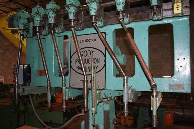

Comments: 7 gears heads with shafts, spindles and arms.
Source: cmw

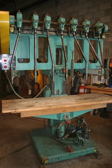

Comments: Old style chain table raising with shop built hydraulic cylinder.
Source: cmw

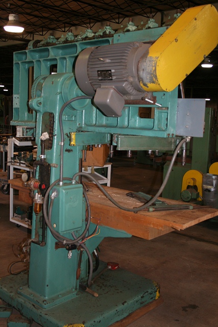

Comments: Recent 20 HP drive shaft motor
Source: cmw

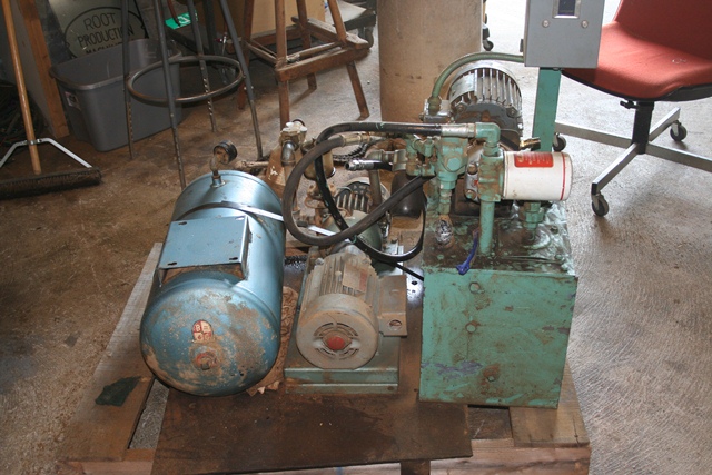

Comments: Hydraulic pack with air tank
Source: cmw

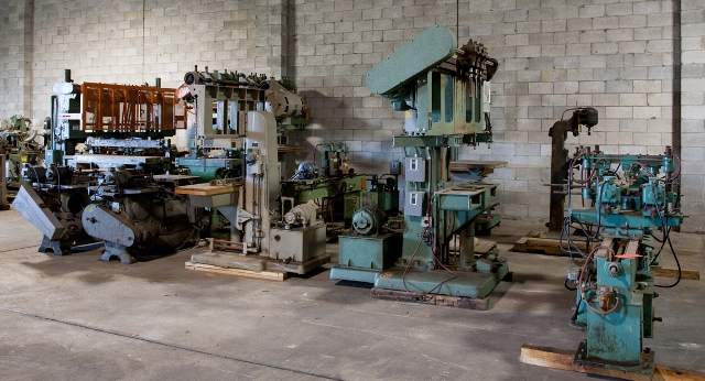

Comments: 10 Roots, notice two the late style Root borers, a CH and a C 311.
Source: cmw
