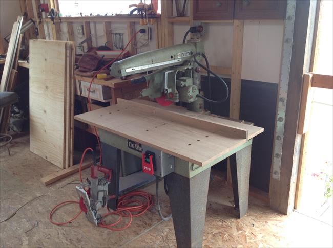

Cover came off this as I walked through my friends backyard,$200 later I have a big brother to my MBF. This one had been used very little ,a day's clean & lube effort brought it back to life. New wiring and switch ,new table, counterweight return and a blade makes it effortless to operate. 1 1/2 hp 220v doesn't notice load like the 9" MBF.date from Rick Antrobus list and motor serial number. Had to learn how to adjust all the variables on this saw, seemed like someone had mis adjusted everything .key switch had been replaced with 2 pole toggle. Love the guy that had the 110/220 switch labeled " hi "& "lo" speed on an old post.
