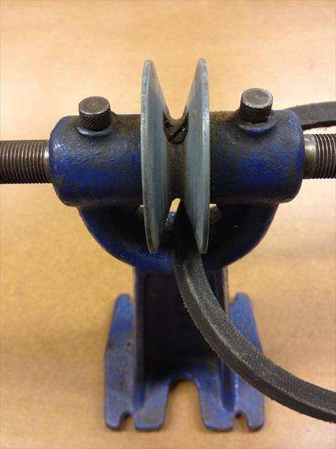

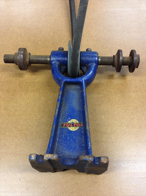

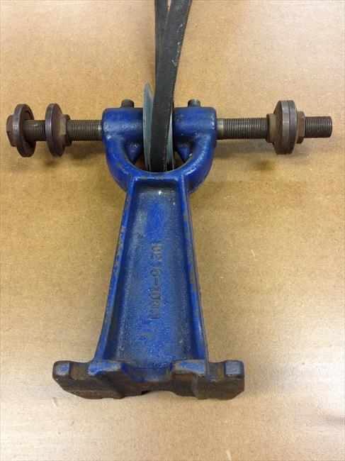

Sears Fulton basic entry level polishing head, built by Central Specialty in Ypsilanti Michigan.
Cast iron frame painted Sears blue (casting number 10276-103.1).
Steel shaft 7½" long, runs in plain iron casting.
LH threaded arbor: ½"-24 x 2-1/8" long
RH threaded arbor: ½"-24 x 2-½" long
Flanges-machined steel.
V-Belt Pulley-2" die-cast aluminum (can be driven from above, behind, & below).
Pulley set screw 1/4-20 x 1/4” cup point with slotted head.

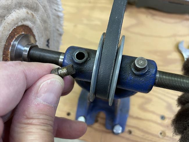

Machined steel oil plugs with felt rod extending to shaft surface. Plugs press fit into frame.

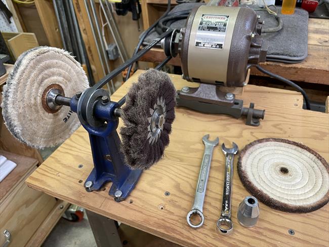

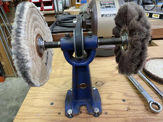

Set up to do some polishing.
Craftsman 115.19741 1/4 hp 1750 rpm motor on pivot mount.
Motor pulley-2.5”
V-belt 3/8 x 30”
Added a few drops of SAE30 to the polishing head felt wick rods.

Comments: Set up for some polishing.
Source: iPhone 12 Pro camera-existing light
Comments: 5/8” wrenches used to tighten flange nuts and position wheels at shaft ends.
