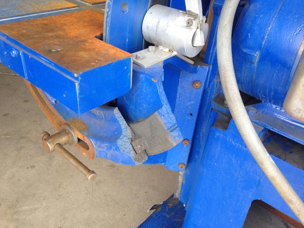

This machine is missing some essentials, notable the entire spindle sanding apparatus. The motor spindle extends out the back and has nothing to do. The last several inches of the right trunnion has broken off, including the rack-and-pinion table tilting mechanism. There is a shop-made (I think) brake added to the back of the disc, right side. Also on the right side I am missing the cover for the rectangular hole in the base, as well as the two Oliver tags, one of which I imagine had the serial number. The knob at the front of the table, which adjusts the table's closeness to the disc, has broken off but the adjustment function still works. As expected, the miter guage is missing.

Broken trunnion and shop-made brake.
