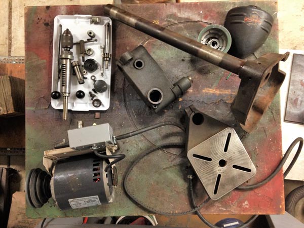

The Workshop series was a mid-century Atlas family of modestly-priced machines for the home shop. This DP is solidly made and still very tight and smooth. Since I did not anticipate using it very much, I chose not to replace bearings, but rather just took it apart, cleaned and lubed everything, and polished and painted it up.

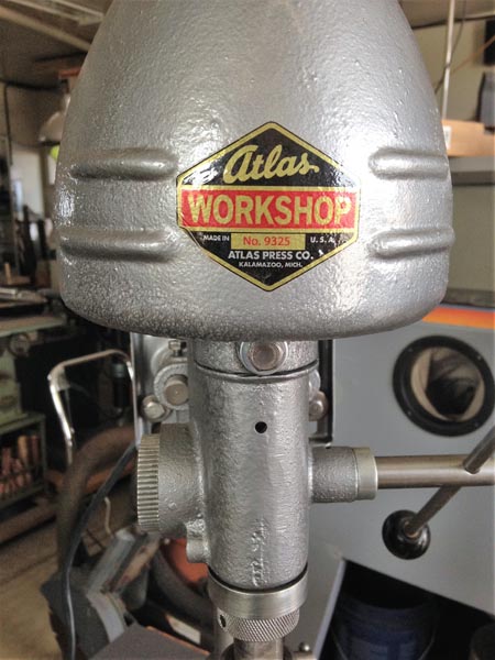

I made a new decal, thanks to Bob Holcomb's artwork entry in this web site. The motor didn't look right so I replaced it with another which I found on the shelf. The keyless chuck was goofy but works fine now with cleaning and replacement of two of the three springs.

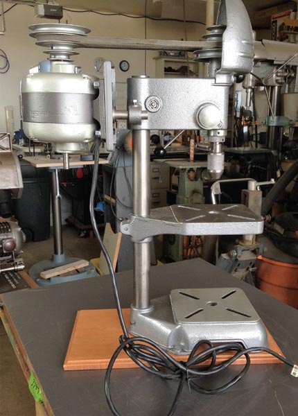

Comments: off-balance to the rear, requiring mounting to a wooden base for stability.

Comments: Disassembled for restoration

Comments: New decal, but not centered well.

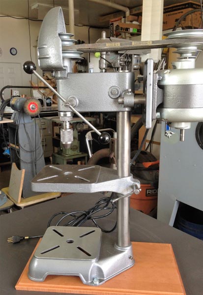

Comments: R. view

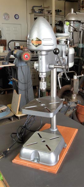

Comments: L side

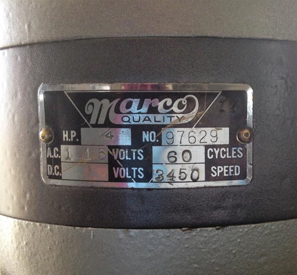

Comments: Replacement motor.
