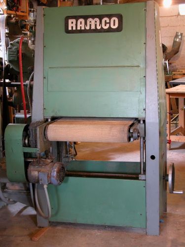

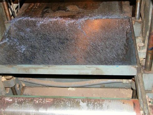

Worst wear issue was the bed, which was wallered out into a wide trough almost 1/16" deep at the front center of the entry side. I scraped the table flat over a "several" day period. Judging by the remaining blanchard grinding marks contrasting with the spotting from the surface plate used to indicate for scraping, apparently, the original grinding had been none too flat, either. It is now. The mechanisms which spring load and guide the hold down rollers is poorly designed, and there was remachining and selective assembly required. Apparently the sander may have been retired when the guides got sloppy and the rollers began deviating enough to hit the sanding belt under load, flatting them. It was here that the spare parts machine proved invaluable. Plus all the extra control parts for both the pneumatic and electric system. It took some time to sort, repair, and baseline the pneumatic system; but despite the spotty reputation of air tracking, it works well. Nevertheless, it's an airhog, and a retrofit to a more modern electric eye system is being contemplated.
New bearings and bearing housings were fit to the contact drum. After the other repairs, machining work, and systems were sorted, the bed was aligned to the drum shaft (axle). Then the contact drum was ground to the bed as per factory described procedure. After the drum was straight and round, the conveyor was re-installed, a new 100 grit sanding belt mounted, and the conveyor was kissed off to bring it flat and parallel with the drum.
The machine can be operated as a light abrasive planer with the platen out, or as a finish sander with it installed. However, it is either in or out; there is no adjustment in use as with later machines. (The platen support/carrier can be adjusted for initial set up as desired. But the procedure is done in the machine with the belt off and indicators to the bed to keep the carrier frame parallel) OTOH, since 2 platens are available, it seems that they could be set up for 2 different applications or contact heights and readily interchanged.
The RAMCO came with a 20HP motor; but after about the 6th start, blew the breaker on the pole pig, requiring a visit from the power company. So I replaced it with a 15HP, and it now starts fast, smooth, and with minimal light dimming.

Comments: outfeed side

Comments: infeed side. The sheetmetal for this side was left off so the belt can be watched on start up. Open access also makes it easier to keep the machine clean inside.

Comments: "And miles to go..." About 3/4 done scraping the bed flat. There's still a lot of material to remove. Still rough scraping, i.e., moving off as much material as possible with every stroke. Finesse (finish bearing and "appearance") will come later.
