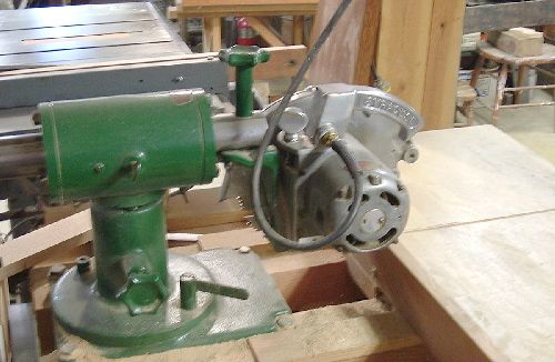

Had a great visit with Joe. I was esp. impressed with the simple but very functional "clover leaf" attachment that holds the saw and them lets you loosen it to rotate the saw in 90 deg increments.
Business end
JO spy camera

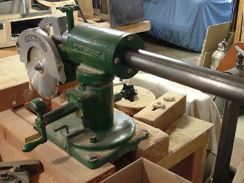

Stroke
JO spy camera

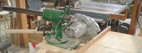

Nice Setup,eh?
JO spy camera
