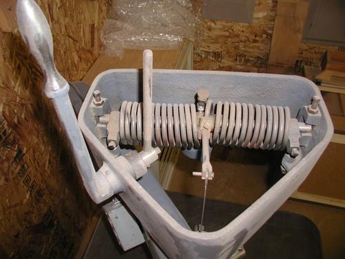

The saw uses blades 1/8" to 1/2" wide and 10" to 18" long, the stroke length is 3" with 10" under the guide if using an 18" blade. The handle shown in the third photo is pulled down to release tension on the blade. Blade changes can be made in seconds. At a list weight of 1700 pounds it runs vibration free. I don't have a lot of need for this saw but it is fun to use. These saws are not in very high demand and when sold often go cheap. My kids love it.

Tension spring assembly, If you've wondered what was up there now you know!
