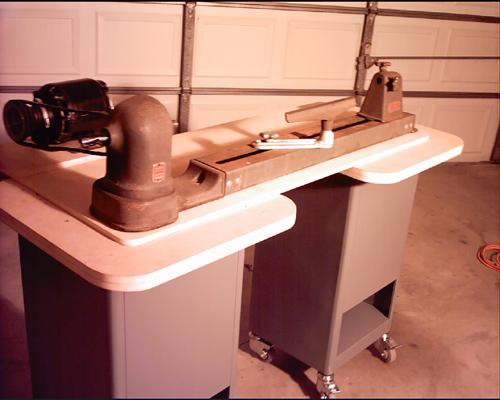

I bought the Toro Lathe on ebay for $35. It had the original motor and some accessories. It functions well so far. I purchased some Morse #1 taper components for it and I am in the process of restoring it completely. The tricky part was to build a table to support the lathe and the motor in a way that allowed me to change the belt locations easily for different speeds. The table is mdf and it has 5/8" x 14" square "feet" on each end that drop into a 5/8" x 14" recess on each stand. The stands were old 11 x 17 file cabinets my church threw out. I gave them new life as a "tool dock" system for my bench tools by adding total lock casters and new hinged tops. I store the accessories inside of them by lifting the lids.

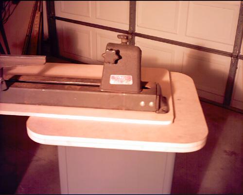

Here is the lathe bolted to its new stand
My Old Bad Camera
This is the Toro brand label "horns and all".
My Old Bad Camera
