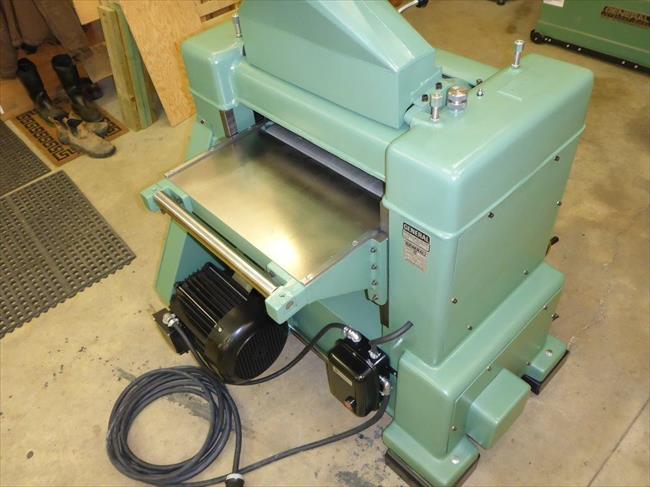

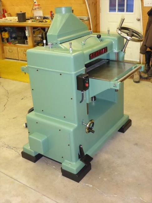

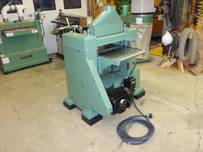

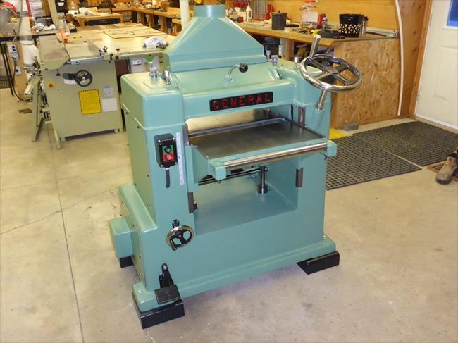

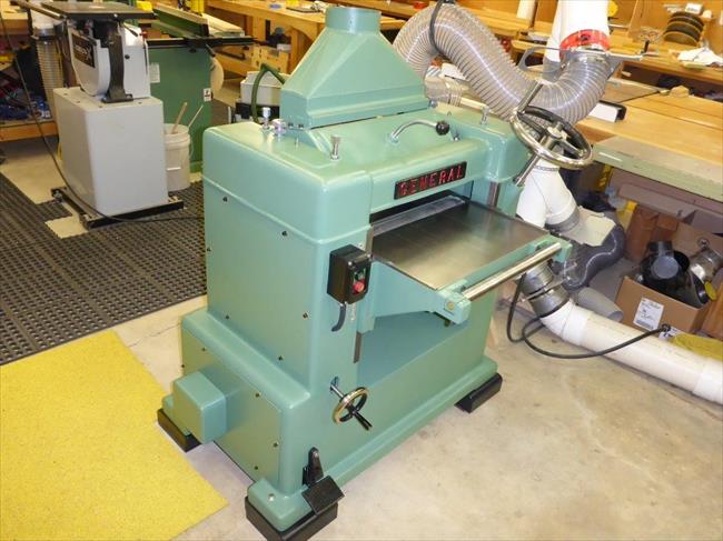

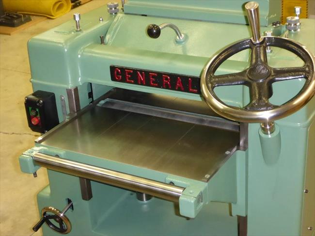

I bought this machine in Calgary, Alberta in 2013 there was a few things wrong with it at that time. It sat in my storage shed until the spring of 2015 when I took it completely apart. Anything that was worn out or broken got replaced, I was able to get most of the parts from General. After some paint this what it looked like in the fall of 2015.
Front

Right Side

Back

Machine Tag

Left Side

Moved to where it will be setup.
