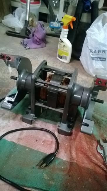

I bought this new in the mid-to-late 1970s. Used it a few years, then "lost" it until recently. When I got it back it was rusty, the start relay was bad, and it was missing one eye shield and one wheel guard. The wiring, bearings and motor were still good. I disassembled, cleaned, painted, replaced the relay (a bear to find one that works)and made new eye shields. It runs smooth and looks much better.

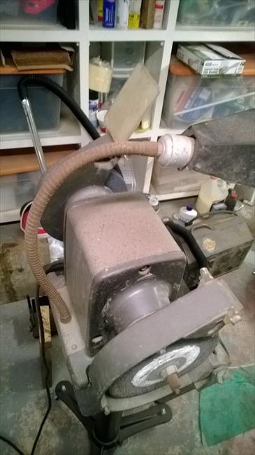

As received.
self

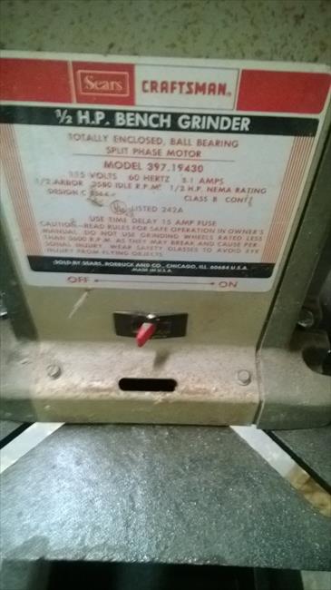

Name plate.
self

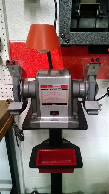

Cleaning up nicely.
self
It works!
self

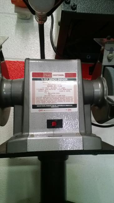

nameplate
self

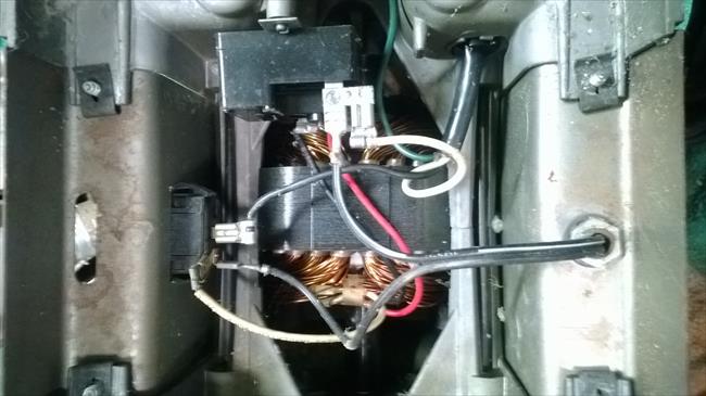

wiring connections
self
