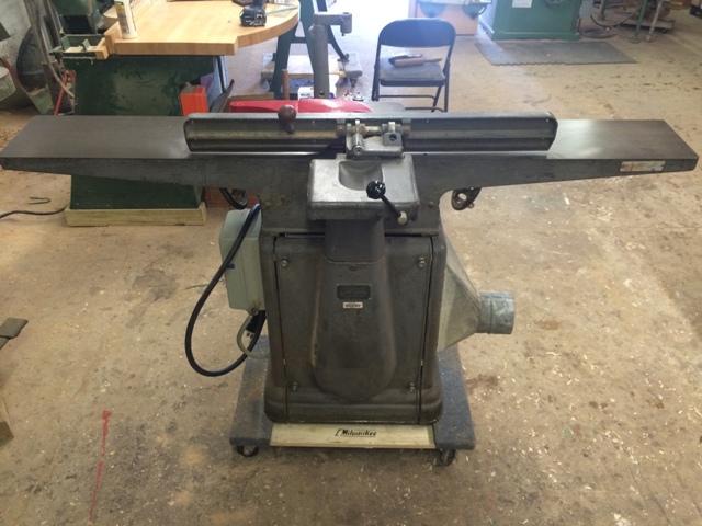

I bought this machine from the Bergenfield NJ High School in Bergenfield, NJ. It was not in use because the guard was broken. I bought a new guard off ebay, installed new bearings in the cutterhead and motor, and installed a new belt. It runs like new now. I am looking for the locking handle that locks the fence when tilted, as it was MIA when purchased. Nice cast iron art deco base, 66" long table, 1hp, 3 phase, 240/480v original motor, currently wired for 240v. Includes nice Furnas magnetic starter.
Front of machine
me

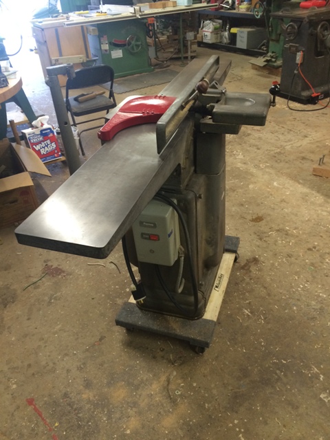

Outfeed side
me

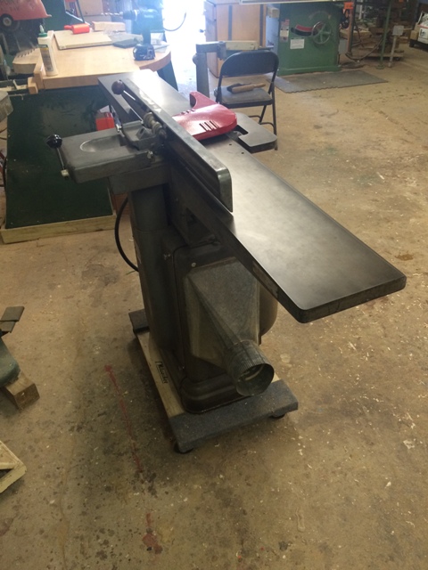

Rear of machine
me

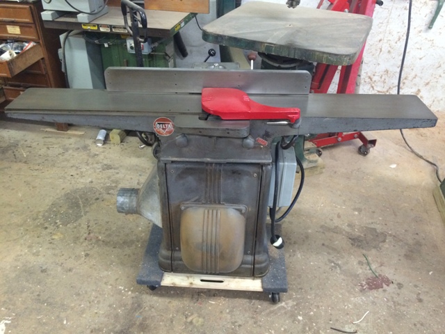

Infeed side of machine
me

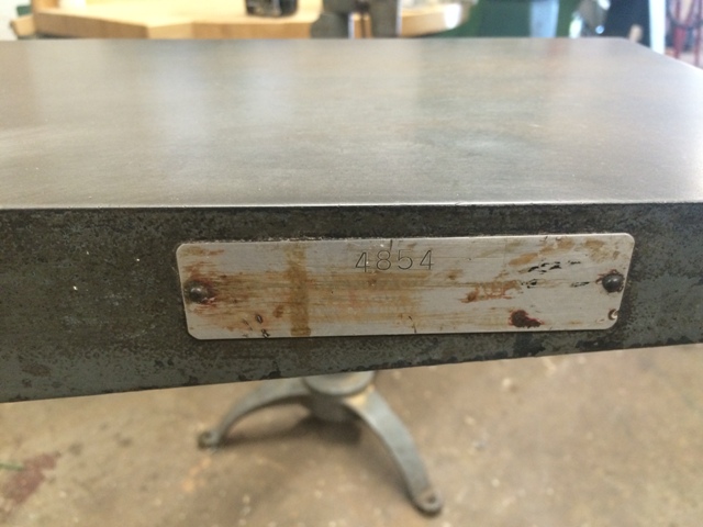

Serial number tag. 123-4854. 123 is very faint!
me
