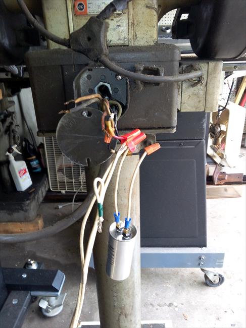

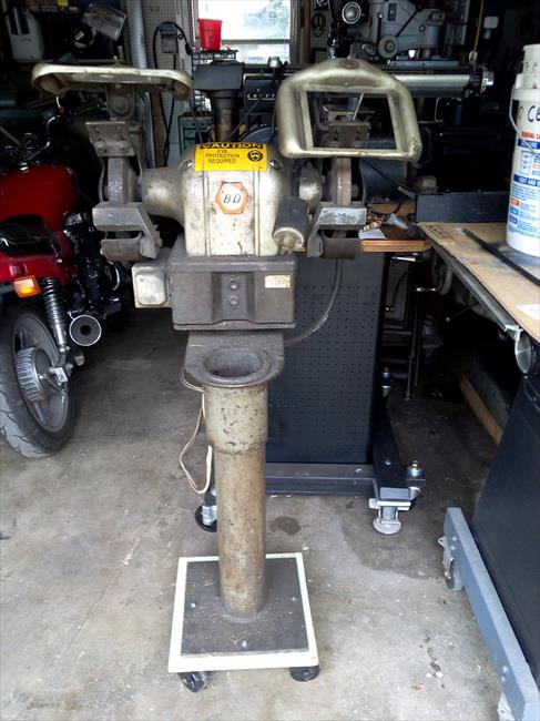

Won this grinder & pedestal at an auction. After finding out that the motor was 3 phase, I had to do some research to find out how to connect a 3 phase motor to a single phase (220 volt) power supply. I found that all I had to do was wire in a run capacitor across one of the motor windings. This is the smoothest running grinder I've ever seen. It takes over 5 minutes for the wheels to stop spinning after the power is shut off. I plan to rewire the machine, install new glass in the shields, and completely clean it up. It will probably get repainted in a few years.
front
my phone

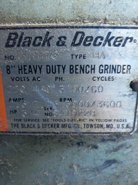

Name plate
My phone

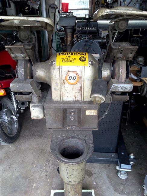

Close up of front
my phone

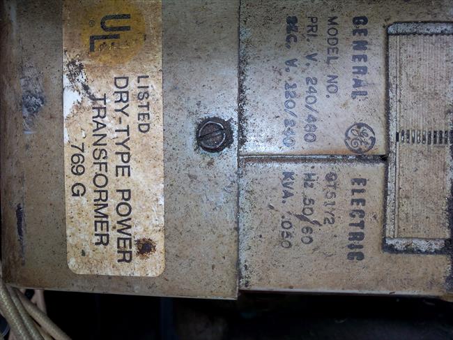

Step down transformer to power control circuit and work lights mounted in shields.
My phone
Temporary wiring with capacitor hooked up.
My phone.

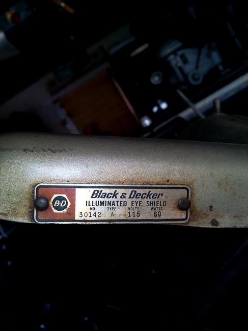

Information tag for stock eye shield assembly.
My phone
