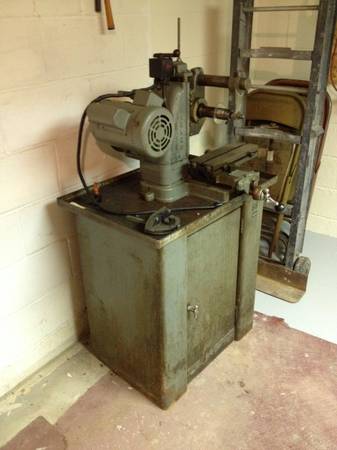

This is not my milling machine. Seen locally. Machine is in very good working order. Has it's original stand/cabinet/cooling system. Missing lamp. 115V/1Ph/60Hz. 1/3hp Motor. Info fm website: http://www.barkermill.com/pm.htm
Dimensions: Overall -
Width 22-1/4"
Length 24"
Height 18-1/2"
Net Weight 175 lbs.
Shipping Weight 195 lbs.
Range: Table Working Surface -- 4" x 12" -- 1/2" T-Slot
Table-Longitudinal Travel -- 5"
Head-Vertical Travel -- 3"
Saddle-Cross Travel -- 3"
Spindle: Spindle nose -- #3-C Standard Collet Taper
Spindle capacity -- 1/2" diameter through Collet Draw Tube

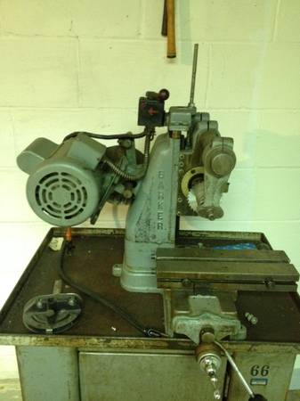

Note: BARKER name oriented vertically on center machine post, as I'm calling it.
