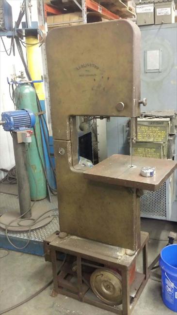

This saw was spotted for sale locally. Photos are posted with the owner's permission.
It's labeled Will Krumbach, which means that it predates the time when Krumbach adopted the "Burlington Sander" trade name. ("Burlingon Sanders" were Krumbach's most successful line, and it appears eventually became their only product.) The saw takes a 10' 10-1/2" blade. The saw has rubber tires. With the jackshaft in the base it looks like this saw is geared down for metal cutting.
