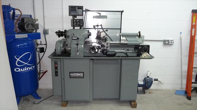

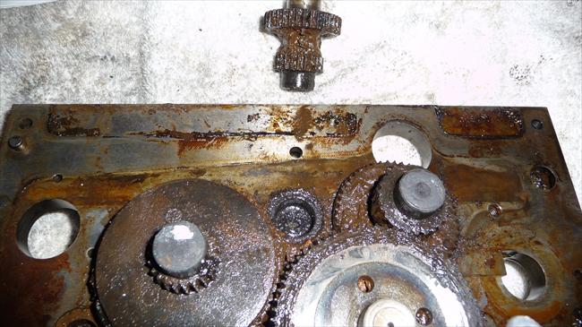

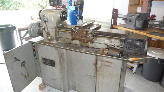

Purchased from a small shop in Palm Bay, Florida in March of 2014. The motors ran however the collet closer was locked up so the 3 jaw chuck was used until the carriage locked up. Disassembly of the apron revealed the horrors of using water-based coolants on a machine with an unsealed gearbox. All internal gears were replaced along with the clutches. The machine functions like new and is dead-on accurate, and threading is a pleasure. I added a Newall DRO that really makes this a nice addition to the home shop.
Restored HLV-H

Internal condition due to water-based coolant. Note the geartooth degradation

As-Found Condition
