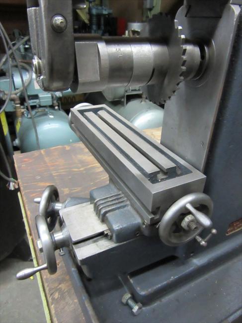

Machine Type: Mill, Horizontal
Submitted By: Jeff Hammerling
Description/Model: 0000 Horizontal Mill
Last Updated 4/15/2015 10:01:01 AM
Found in a sales ad. The seller provided the following information;
Childs & Co Model #0000 Horizontal Mini Mill - Complete Setup
Technical Specifications:
Voltage: 115V / 1Ph / 60Hz
Motor RPM 1725
Motor Size: 1/3 HP
Table Working Surface: 2" x 10"
Table Longitudinal Travel: 4"
Arbor/Spindle size: 5/8" Diameter
Arbor Taper: #1 MT
Head Vertical Travel: 2"
Saddle Cross Travel: 4"
Dimensions: 29" x 23" x 56" h
Weight: 175 lbs
Made in Conneaut Ohio / USA
Equipped With:
Wood base
This item is in very good condition!
