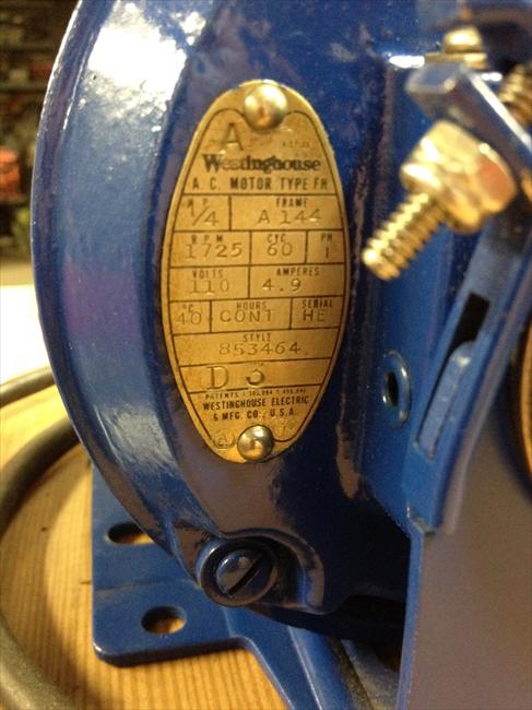

Motor
1/4 HP
Dean Franklin
Type FH
Unknown
853464

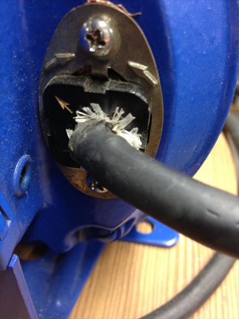

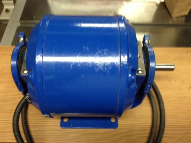

Found at estate sale covered in dirt, grease, and yellow paint. Dissembled, cleaned, reoiled, and repainted. Blue was the original color found under the grime and yellow paint. This motor has a unique way to reverse rotation. The cord is connected to a square block with white arrows on it and held in place by a plate with matching arrows. To reverse rotation simply remove the plate and match the arrows on the block to the arrows on the plate in the direction you want the shaft to rotate.
Westinghouse 1/4 HP motor

Motor Tag.

Cord block with direction arrows
