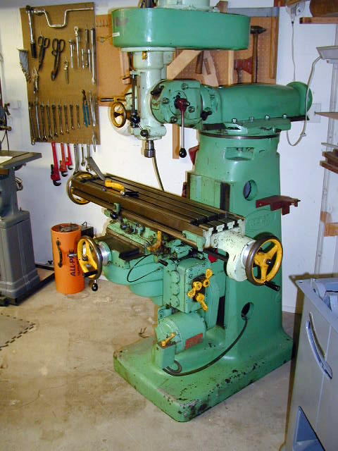

Purchased in 2006 from a local machine broker for $1250. The machine came out of a lab at University of California at Berkeley. Completely restored since purchased. I had the draw bar assembly re-bored from B&S #9 to R-8 by the factory. Three phase, one horsepower, nine speed 80 to 2700 RPM. Motorized table on the X axis.
Comments: post restoration
Source: my camers

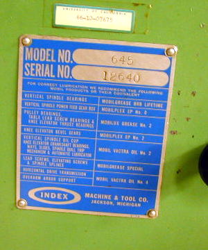

Comments: model and serial number
Source: my camera

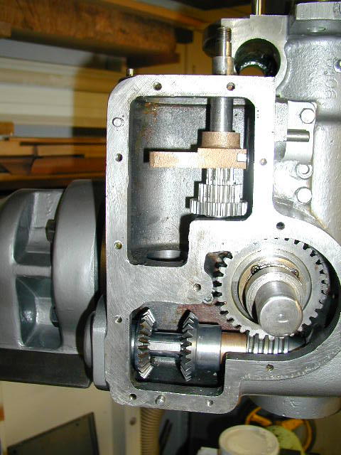

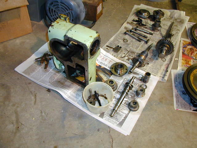

Comments: disassembly
Source: my camera

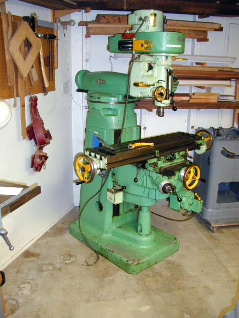

Comments: re-assembly
Source: my camera
