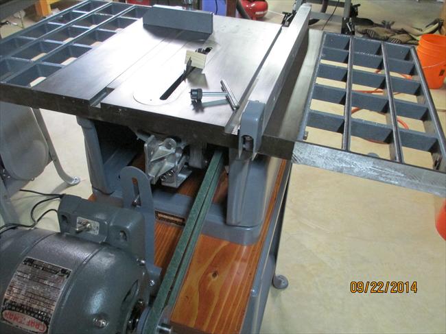

Bought this in 2012 from a CL ad posted during our time in Madison, WI. Brought the un-restored near complete saw with me, along with a Delta welded-steel stand, to Virginia when we moved here in 2013. Finally began stripping and de-rusting the saw, parts and stand last June and did my painting in August and re-assembly in September-October. No need to hurry these days.

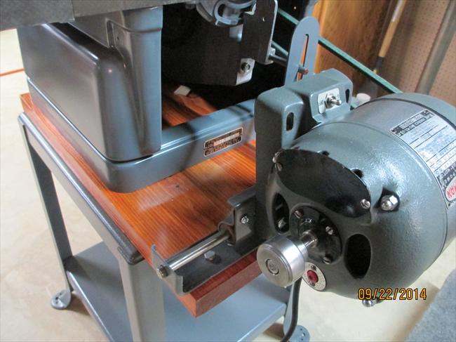

Added a wood base over steel table top to accommodate the Sears/Craftman motor and mount per manual and cut first wood in October. Have been fine-tuning and tweaking this and that lately. Will be using the little saw for soft wood cuts and maybe some thin hardwoods. Need a good blade to go with the 1/2 horse resto'd Craftsman motor.

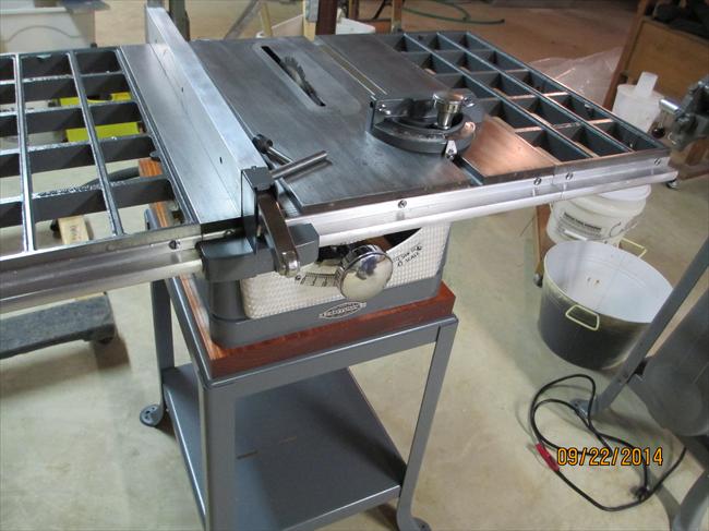

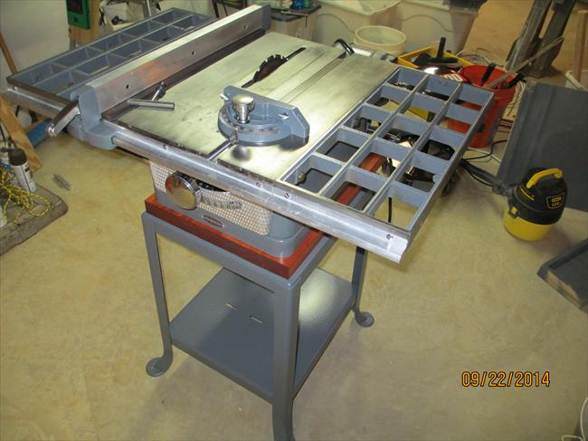

Saw, stand, fence, miter

another angle. tool on table is a golf cleat wrench, now suited to fence adjustment

motor end
my cam
motor with shaft knob in place

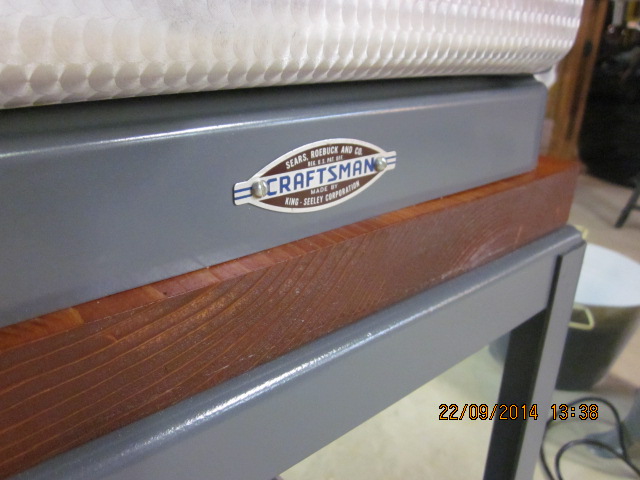

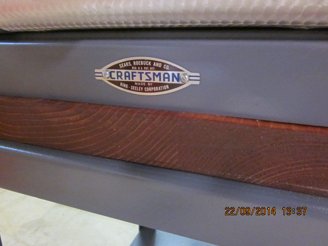

managed to lose or misplace the original badge - first time for that- had to purchase one from Internet source
